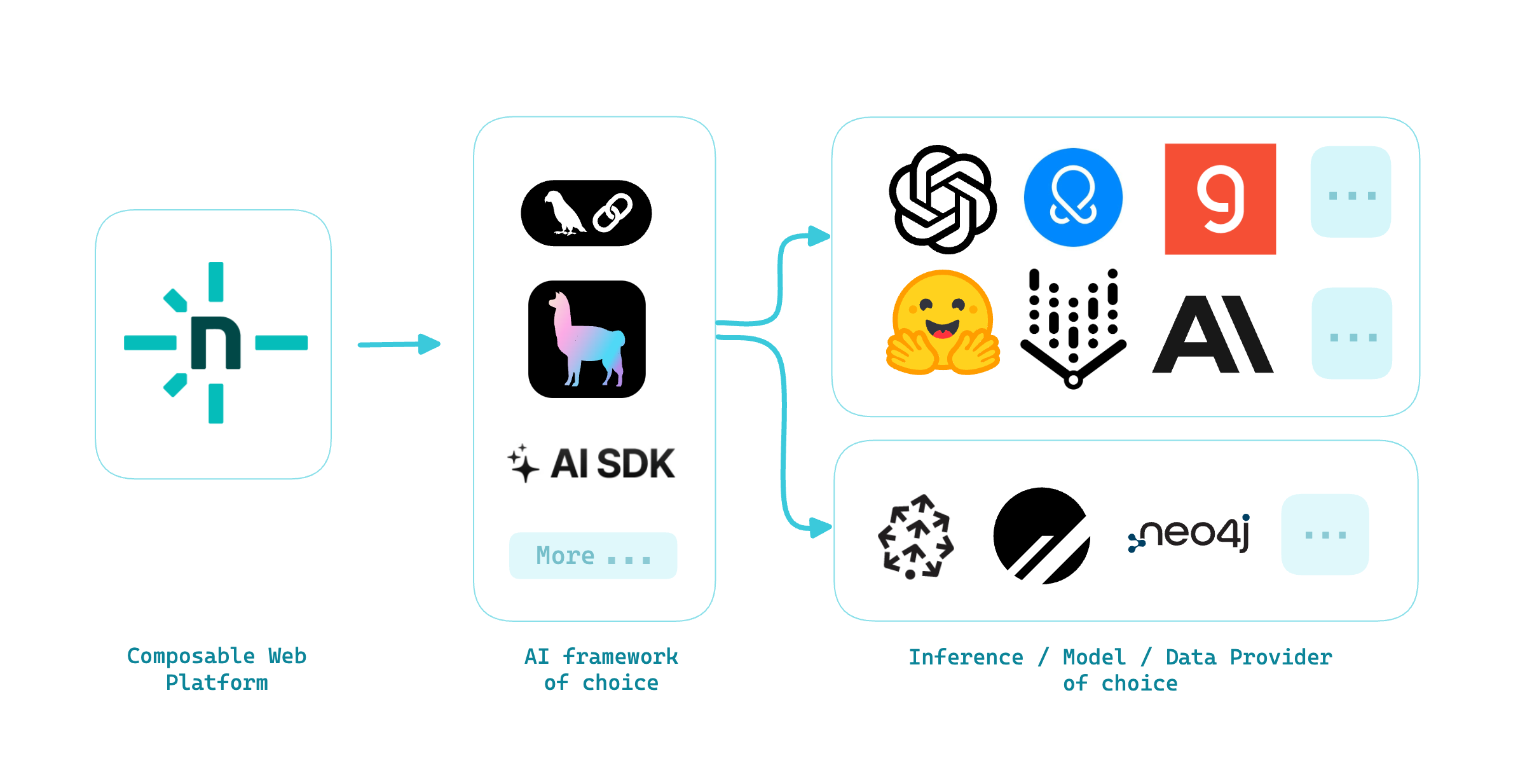

Composable AI stacks
With a usecase and concept in mind, you’ll want to get to building on your stack as quickly as possible. Netlify’s composable platform let’s your team decide the right combination of tools to use to achieve your goals.
UI / Framework stack
You probably already have a framework of choice and a website you’re building on. If you don’t, here are some templates to get you started with a site on Netlify.
For most usecases, AI solutions tend to be a server/backend concern. It’s often treated as an API layer separate from your frontend stack or integrated into it. That is to say, like your site’s other server concerns, your AI layer will usually look the same and sit next to the rest.
For example, if you’re building Generative UI via React Server Components, you are already integrating your server logic next to your components. Most websites today utilize a more trigger oriented flow - user interacts with UI, an API call happens, and UI is updated to reflect the information. Both approaches are supported on Netlify so you can use the approach that fits with your current site.
Any Model. Any AI Pattern. Any AI Framework.
Within your website architecture, you can decide which model and provider you would like to use. Netlify’s serverless runtime allows you to start working with AI without worrying about the infrastructure that powers it.
Access any AI model from a provider of your choosing. Here’s some that you might be interested in for your usecases.
  • OpenAI - powerful proprietary models
  • Groq - extremely fast LLM inference
  • HuggingFace - extensive library of open models
  • Anthropic - exceptional proprietary models
  • OctoAI - containerized access to models and inference stack
  • Google’s Vertex AI - powerful proprietary and open model access
  • countless more!
Depending on your usecases, you’ll employ various AI patterns. Whether you’re just using basic direct inference, RAG (Retrieval Augmented Generation), or supporting something more complex such as knowledge graphs. These patterns combine compute, data, and inference to achieve results and Netlify is the glue and runtime to make this happen.
As your usecases get more complex, it’s a good idea to start reaching for a purpose-built AI framework to simplify what you need to understand.
  • LangChain - A complete framework for orchestrating different patterns, normalizing provider differences, and making it easy to build and maintain AI systems without needing to know the nuances.
  • AI SDK - Normalizing the responses from AI tools, common utilities, and prebuilt usecase methods.
  • LlammaIndex - A data framework for orchestrating the data workloads used in your AI systems.
If you’re needing a vector database to do some advanced patterns, Netlify supports connecting to all of the major providers such as Pinecone, PlanetScale, Supabase, MongoDB, Neo4J, etc. Just select the tools that fits your needs.
Tools in the AI ecosystem working with Netlify
