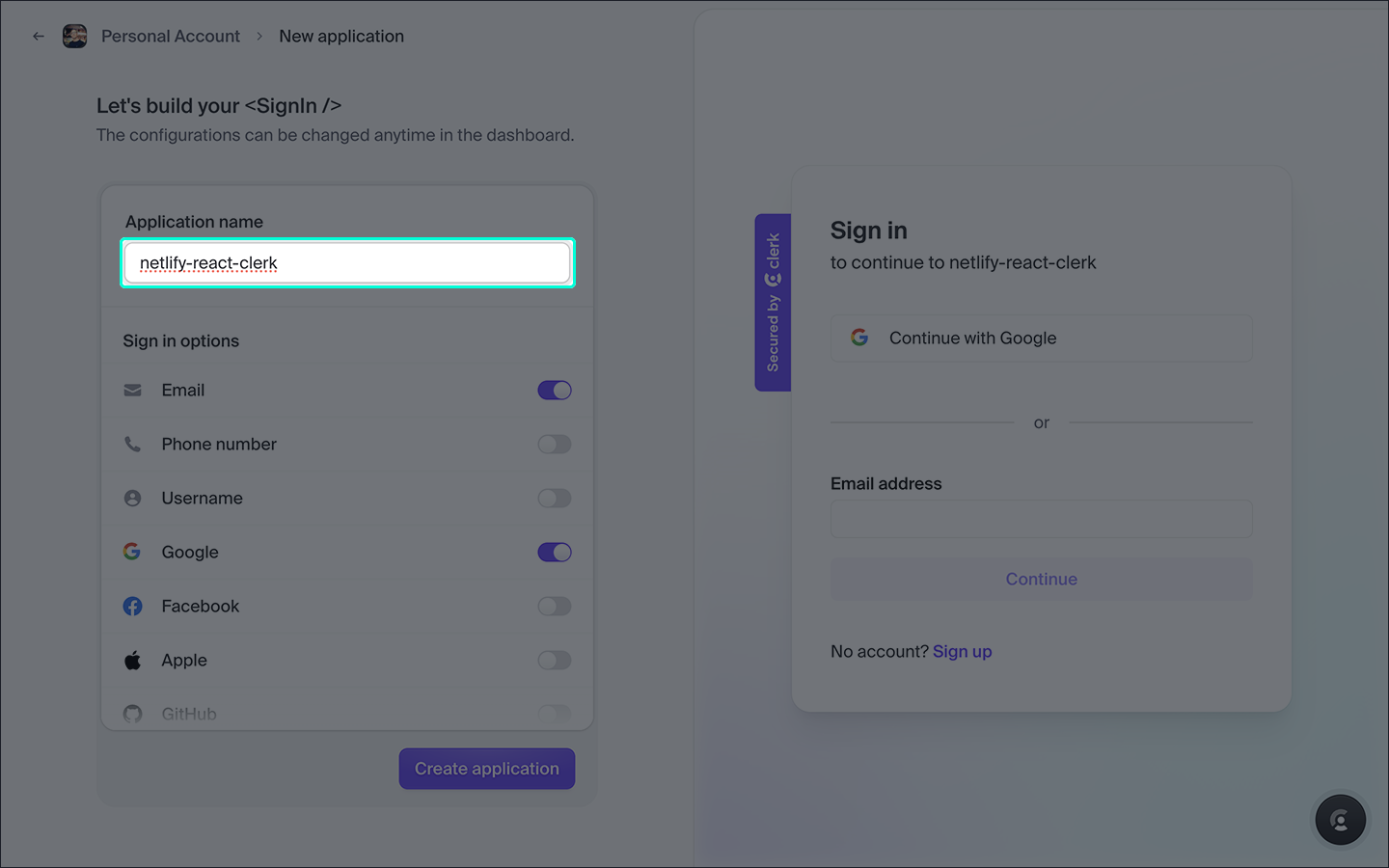

Create a new Clerk project
Once you’re logged in, create a new project and give it a name.
New Clerk project

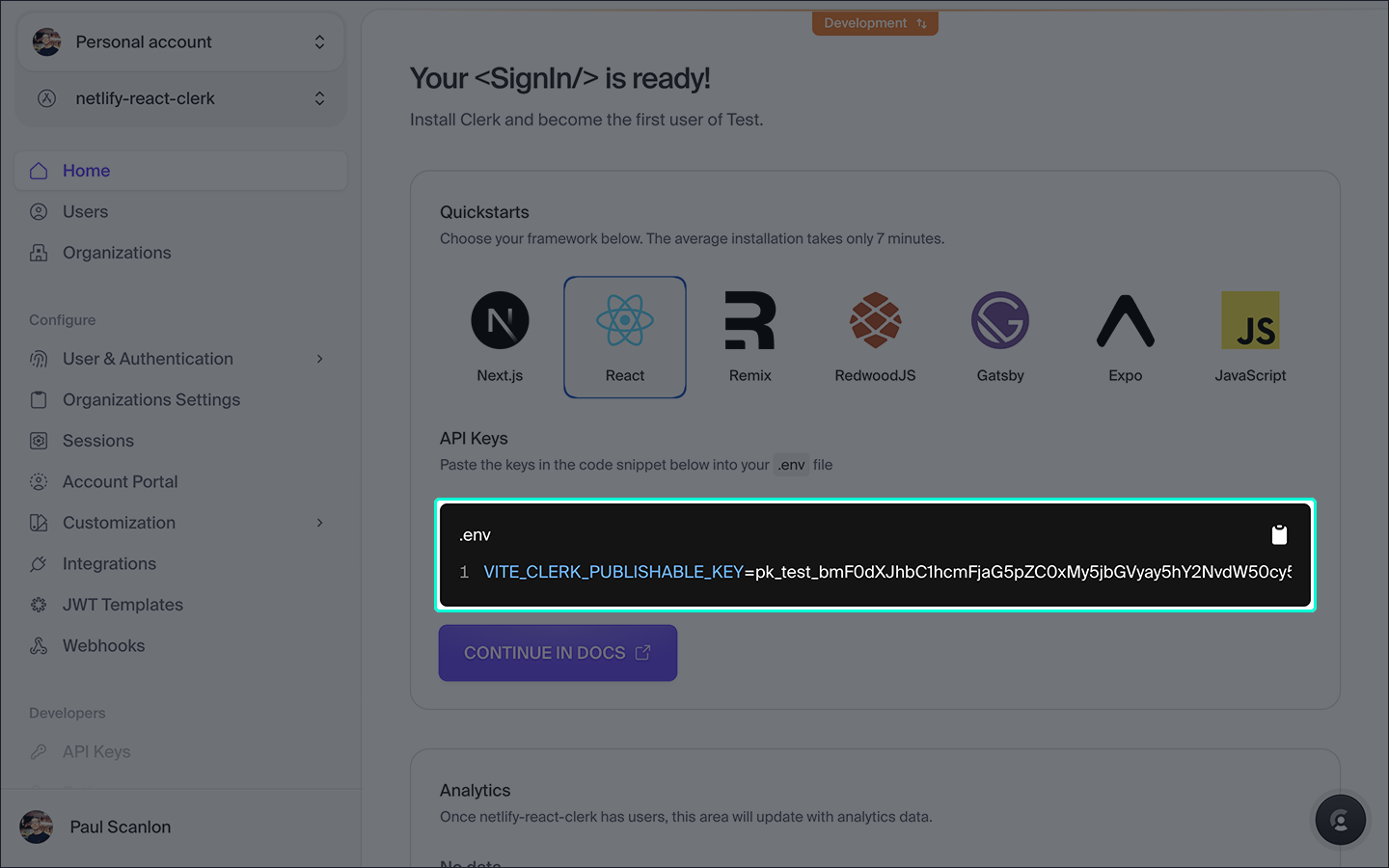

Copy environment variables
Next, create a .env file at the root of your project and copy the environment variables shown in the Clerk dashboard this is how Clerk communicates with your application.
You may also need to update your .gitignore to include the .env file.
// .env
VITE_CLERK_PUBLISHABLE_KEY=pk_test_bmF0dXJhbC1hcmFjaG5pZC0xMy5jbGVyay5hY2NvdW50cyXXXXX
Clerk sign-in key

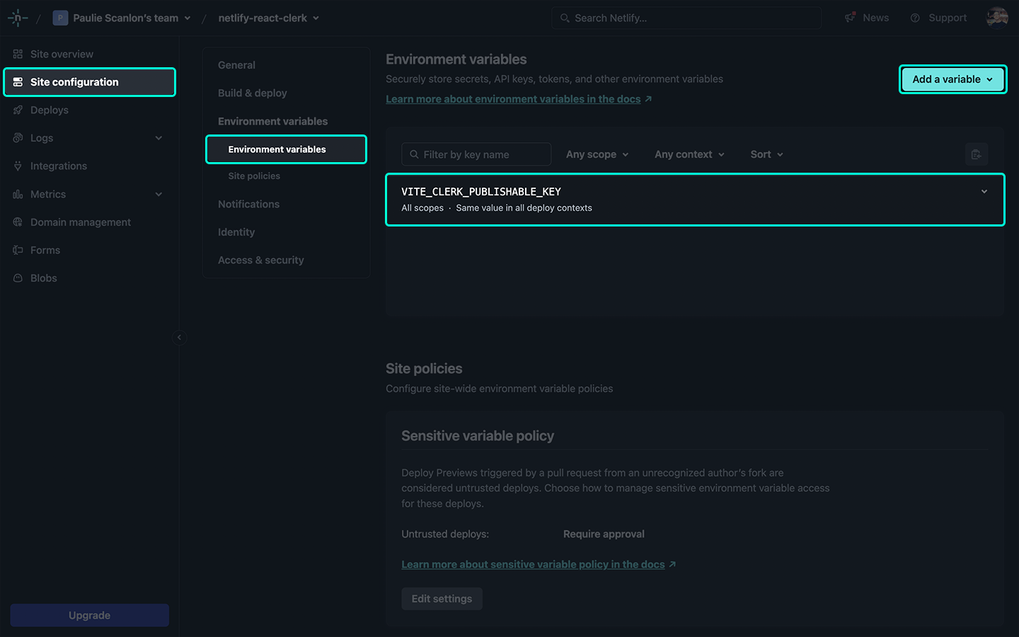

Add variables to Netlify
If you’ve already deployed your application, you can now add the same environment variable to your Netlify site configuration. Select Site configuration > Environment variables from the left hand side navigation.
Netlify env var

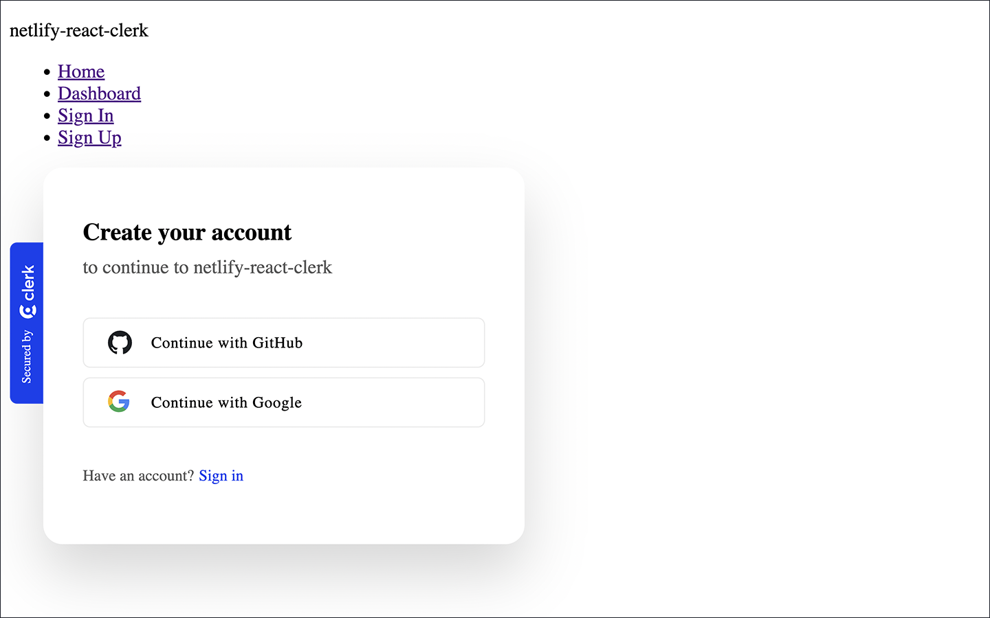

Clerk offers a number of different social connections. In this next section we’ll show you how to add GitHub as a sign in option and disable the default username and password option.
Clerk auth UI

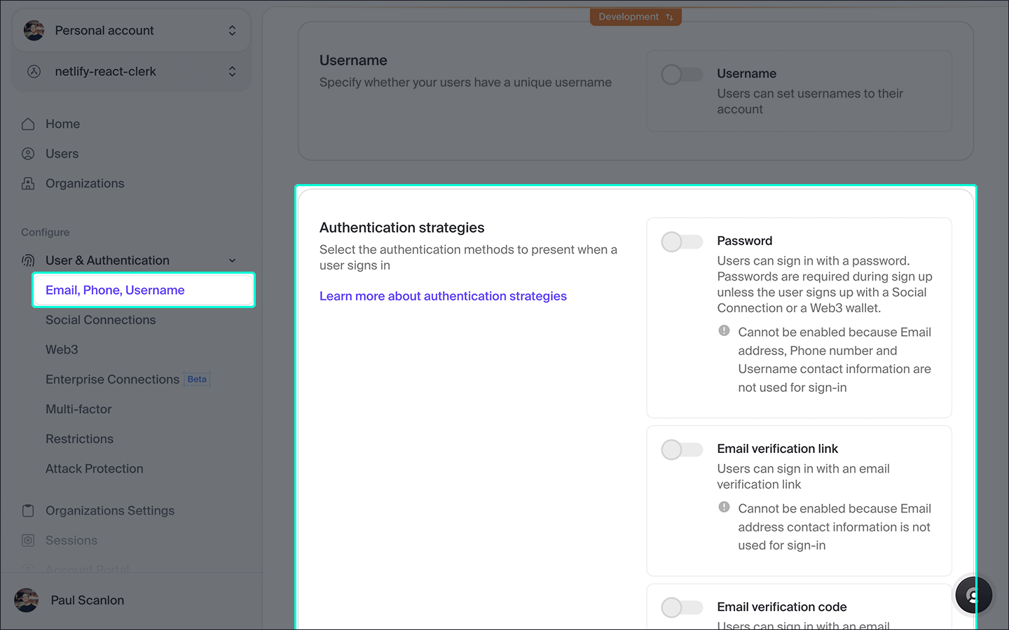

Username and password
To disable the username and password options select User & Authentication > Email, Phone, Username from the left hand navigation. Toggle each of the switches in the Authentication strategies section. Be sure to save your changes.
Clerk configuration UI

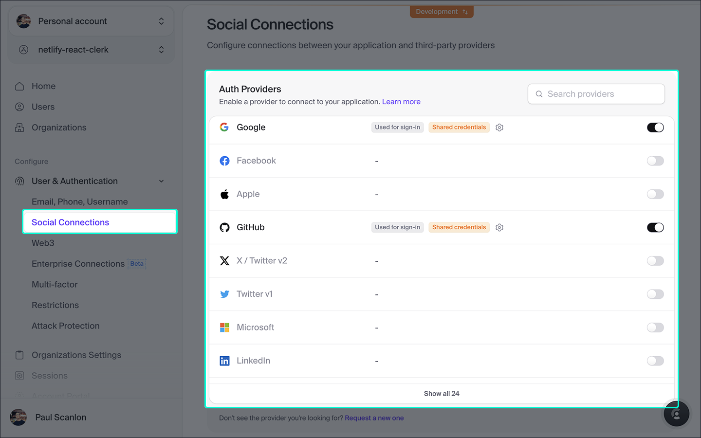

Social Connections
To add a new social connection option  select User & Authentication > Social connections from the left hand navigation and toggle on each provider you wish to enable in your application.
Clerk auth UI
