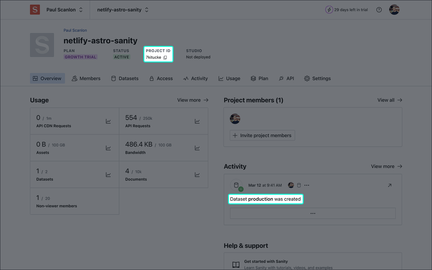

If you now head over to sanity.io/manage you’ll see your new project. Within the project’s settings you’ll find the same projectId
and the dataset
name as mentioned above.
You’ll need both of these in the next step.

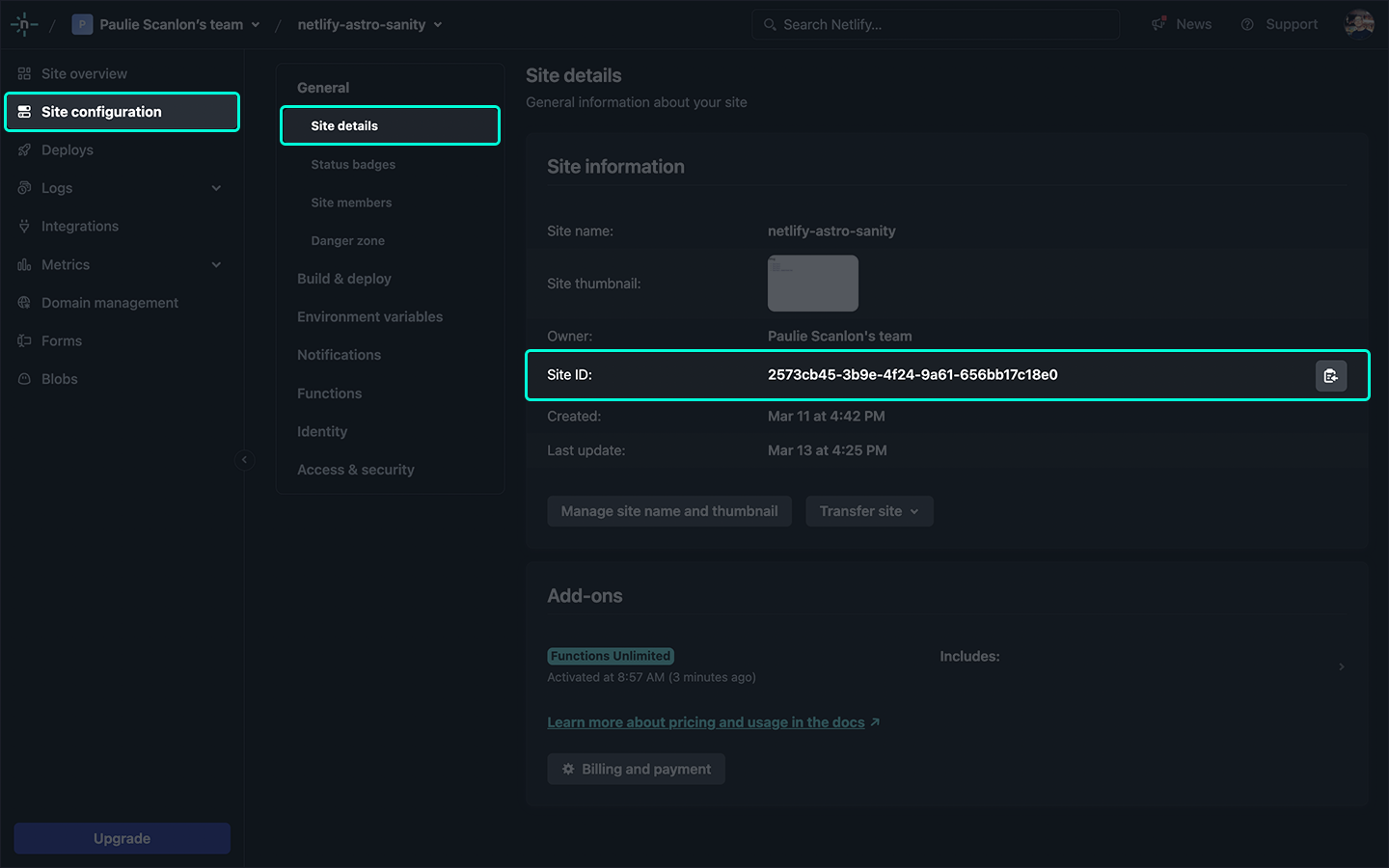

Adding environment variables using the Netlify CLI
To help prevent sensitive variables from leaking into public repositories, you can use the Netlify CLI to automatically add environment variables to both your local, and production environments without needing to create a .env file in your project.
If you already have the Netlify CLI installed, run the following in your terminal to link your local development environment with your deployed Netlify site.
netlify link
A new browser window will open and you’ll be asked to authorize access.
From the prompts in the CLI select > Enter a site id, then head back over to your Netlify site configuration to find your site’s id and enter it in the CLI.
After your local environment is linked, run the following in your terminal to add both the Sanity projectId
and dataset
netlify env:set PUBLIC_SANITY_STUDIO_PROJECT_ID {YOUR-PROJECT-ID}netlify env:set PUBLIC_SANITY_STUDIO_DATASET production

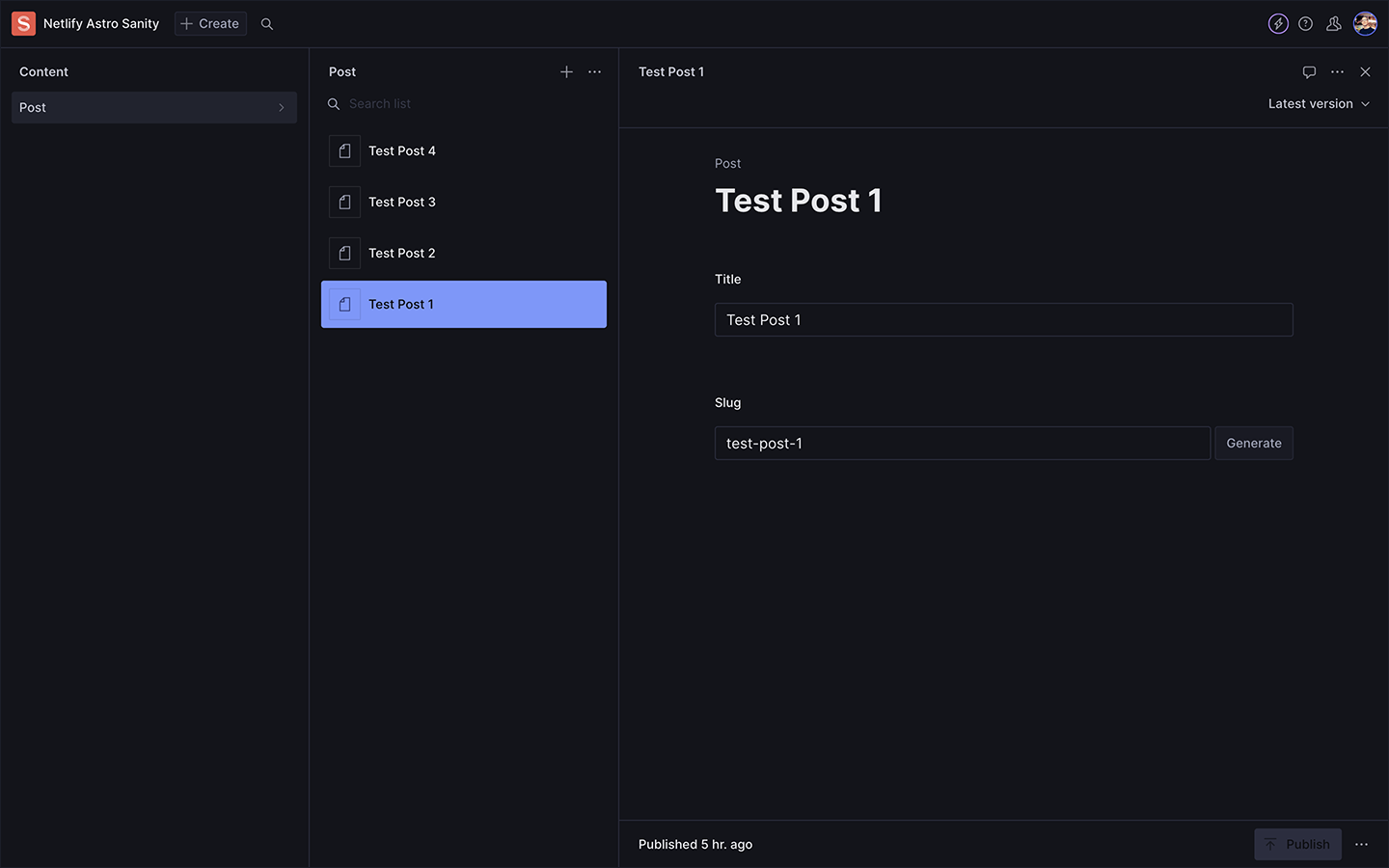

If you start the Astro dev server and visit http://localhost:8888/admin you should be looking at Sanity Studio!
Take care of CORS
The first time you visit Sanity Studio locally you’ll be prompted to add your localhost URL to Sanity’s CORS config. Click the button which will add the URL to your Sanity project.
You can go ahead and add a couple of test posts as we’ll need those next.

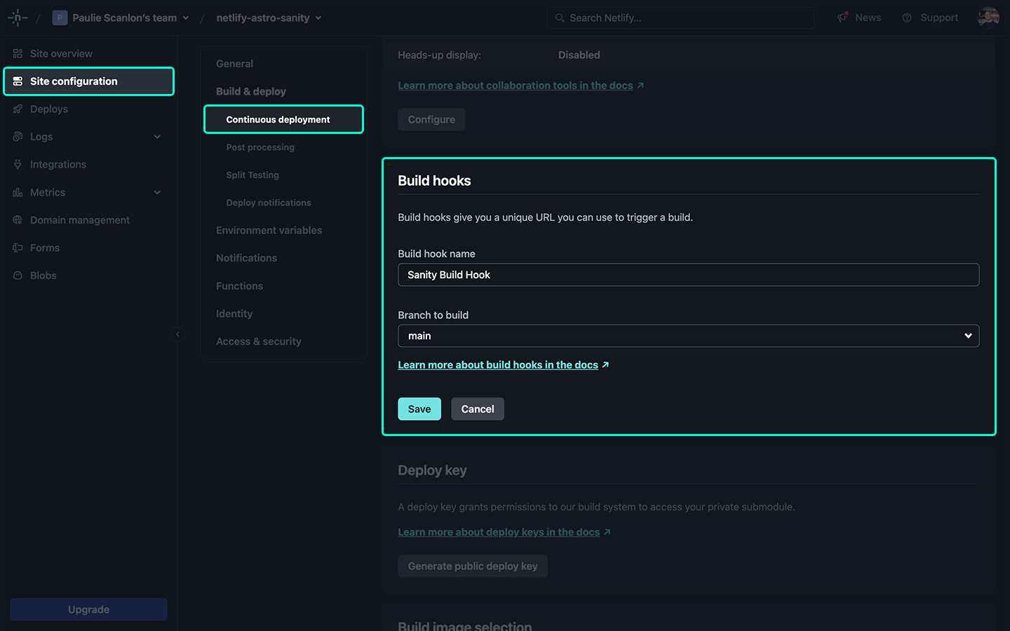

Netlify Build Hook
The first is on the Netlify side. Navigate to Site configuration > Continuous deployment and scroll down until you see Build hooks.
Click “Add build hook”, and give your build hook a name, then select the branch to build from.
If you like, you can read a little more detail about Netlify Build Hooks
In this example we’ve called the build hook Sanity Build Hook and have selected to build from the main branch of our repository.
When you click save you’ll be shown a URL which can be used on the Sanity side of the setup. Copy the URL and head back to Sanity Studio.

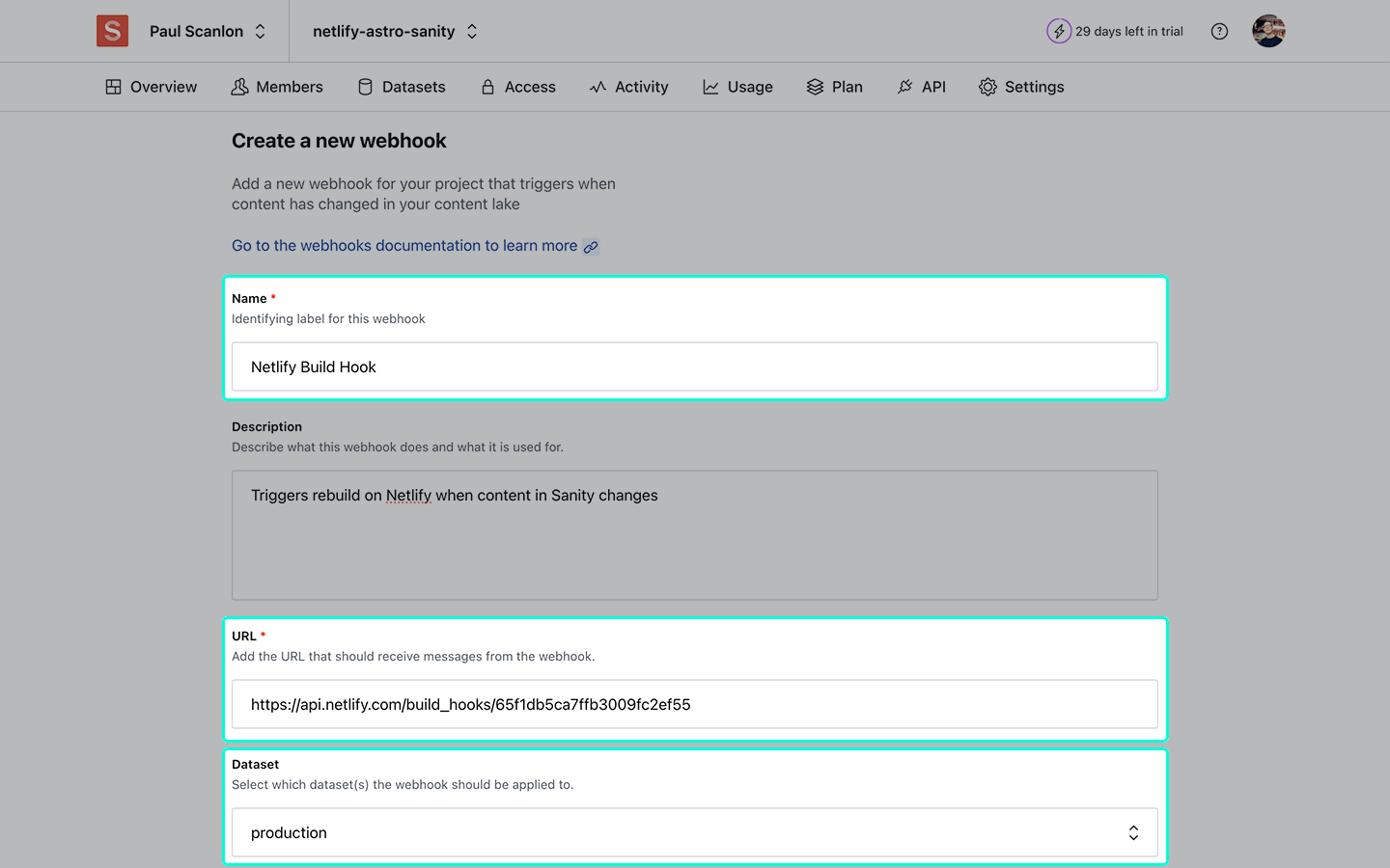

Sanity Webhook
Navigate to API > Webhooks and fill out the fields. Give the webhook a name, then add the URL provided by Netlify. You’ll also need to select a dataset. In this example we’re using the production dataset.

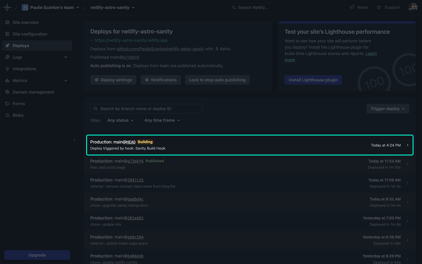

With both sides now set up, go ahead and make a change to the content.
You should notice a new build with the message “Deploy triggered by hook” is now in your Netlify build queue.
Finished
